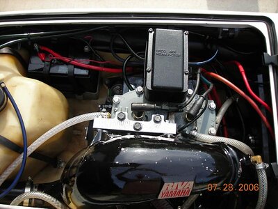

I have a 1999 Super Jet, 701 with a Riva Pipe. I installed the pipe the first time and within 2 minutes of riding it came loose at the cylinder. I reinstalled it, and it did the same thing. Then I installed it with all new nuts, bolts and washers. This time I used medium lock tite. I went out today and it ran great!! I stopped frequently to make sure everthing was still together and tight. At the end of the day it came apart again, this time it broke the studs off at the head tube. WTF!!!! When I installed it I made sure to tightened it down at the cylinder. Then I tightened it down at the head tube so that when I bolted it down at the head bracket it would not bind up. Any ideas??? Does anyone understand what I just said?? I feel like I am taking crazy pills!!! Please Help!!
