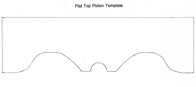

Those Kawasaki pistons in the picture have the skirts trimmed way up. :bigeyes:
I think most people are using the Kawasaki flat tops for the stock stroke lamey engines. You would be wasting you money going with the Riva superstock pistons for that application.

When you expose one side of the ring to the auxiliary transfer port window and have the other side seated against the sleeve you're just asking for trouble. Also the skirts are quite different on the Kawi pistons and they have to be trimmed to clear the Yamaha crank webs. The 80 dollar difference in price between the Kawi pistons and Yamaha specific flat tops doesn't justify modifying the piston and risking internal engine damage IMHO.

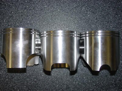

Between the center boost port and the primary port on a 5 port stock cylinder.
Northwest BB sleeve have the primary ports moved to use the Kawasaki pistons.

That ring pin gap rides right on the edge of the auxiliary transfer ports with the Kawi pistons and the NW big bore sleeves too.
Here's a picture of the ring pin locations with the oem piston on the left, Kawi piston in the center and the Riva piston on the right.

these must be northwest sleeves then that lamey used back in the day. cause they are right at the edge,it looks like with the rivas it will be right in the middle between the ports.
