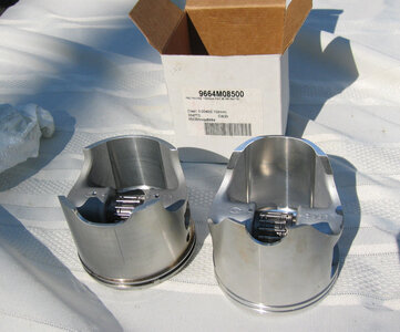

I just got, 3 months ago, a "set" of 85's expensive flat tops from RIVA and decided to use it today...
When I opened it I realized that they have diferent design... one of the pistons is similar to WISECO and the other is like WSM (dark gray top).
The box show the same part # and also the stamped 8500 on top of pistons but one has something liek R&D YAMAHA PMC, bla bla bla...
How can RIVA sell diferent pistons with same part #??
Thanks,
Gera

They look both are forged but some details mismatch them.
The bore are the same for sure.

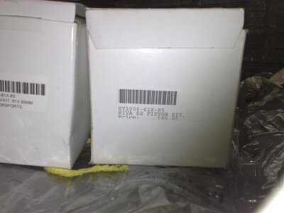

Because this motor is in Brazil and it came wrong packed. When I DID see it was already like this. The mechanic installed it and we had to do it anyway.
The box HAS THE SAME LABEL, SAME PART # and SAME DESCRIPTION.
I didn't get "R&D PISTONS" and "RIVA PISTONS". I get both RIVA SS PISTONS.
I GUESS it was Riva's mistake, dont U.

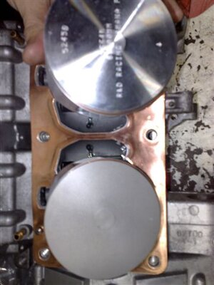

That's interesting because the piston without the coating has R&D Racing stamped on the top. :scratchchin:
I just ordered a set of Riva flat tops a few weeks ago and they both had the coating and matching serial numbers.
I'd say the problem may have started with Wiseco putting dissimilar pistons in the same box.

For those who doubt RIVA would fix it....
Even during World finals season and having a lot of people out of office, I got someone who found an way to fix the problem.
He didn't explain what happened but he got me a piston for free, I am paying for the S/h.
I didn't put the cyl head because I was sure that RIVA would ask the wrong piston but they didn't.
I will bring it to them just to prove that it wasn't used.
POINT TO RIVA

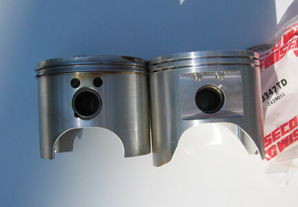

Here's what I dug up trying to fix a short skirt issue. The 'proper' piston for a stock stroke lamey (I'm guessing) is the one with the longer skirts. Also they weigh less, 322g vs 358g. The one with the cut off skirts was exposing the exhaust port to the crankcase @ TDC, apparently not a good idea. What does everybody else use for these cylinders?
Flash-FX. For stock stroke Lamey's I get cheap WISECO KAW pistons and just cut the skirt to prevent it to hit the crank webs.

Those Kawasaki pistons in the picture have the skirts trimmed way up. :bigeyes:
I think most people are using the Kawasaki flat tops for the stock stroke lamey engines. You would be wasting you money going with the Riva superstock pistons for that application.
