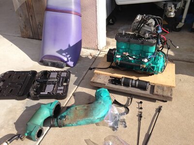

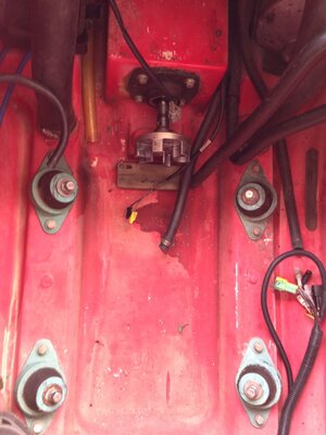

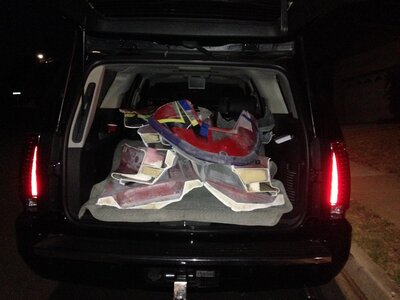

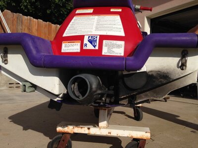

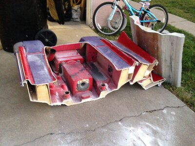

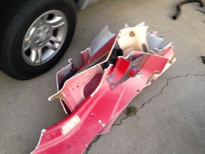

Now take the exhaust trail out. The hoses may be able to be re-used with the routing of the new rear exhaust system. This is why buying a whole donor ski is better than grabbing a motor and all the tid bid pieces. Not to mention the fact you can verify the whole system together runs before you disassemble. The coupler biscuit (rubber piece between the couplers) , exhaust trail, electronics, throttle cable were all kept. I also took those rubber straps as I may be able to use them to hold down the new water box. The ZXI water box cannot be used with the blaster conversion. You need a GP760 or Raider water box with modified baffles and converted collars so the entire exhaust is near 3 inch diameter. (Correction 2.5 inch)
