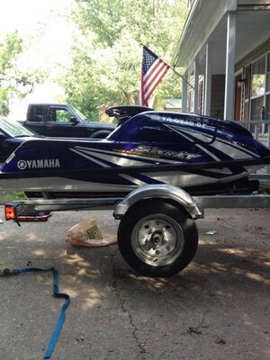

thanks, now in that first picture, is the pole as far down as it can go? it looks like theres a breaking point due to the height of the oem hood

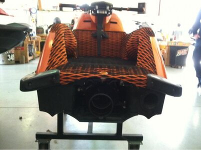

No it's just raised up so you can see te pole better in the picture.. The pole will go all the way down... It just sinks into the cavity of the stock hood because the pole is thinner than the stocker...
From the rear but just to show u that the pole will in fact go all the way down.
cool that makes me feel better. my friend has them on his 2 superfreaks and i have a 2010 sj so my steering sucks. im not really worried about looks atm, just want better handling then the doo doo 08+ steering lol
Sounds good. You'll definitely like the hand pole... It was a bit different at first as the pole doesn't run a spring so it's stiff and you have to literally put the pole where u want it when u ride. Thts actually become my favorite part Ab the pole. Mines coupled w the xmetal steering, turn plate and bars w the umi bearing. I can't stand to ride stock steering anymore. It's much much better.
