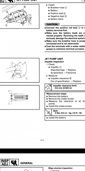

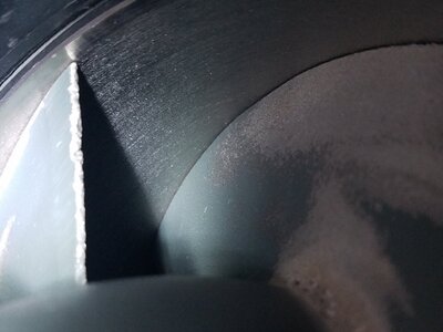

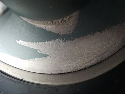

Pretty sure I need to replace my wear ring. My clearance is .009" around most of the ring. Couldnt get that to fit in the top. There appears to be very little, if any, gap at the top. What are my options for a replacement? Do the plastic liner type work or junk? I'm replacing the impeller as well. It's a 99 RN Sj.
