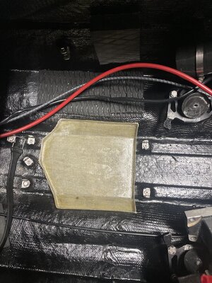

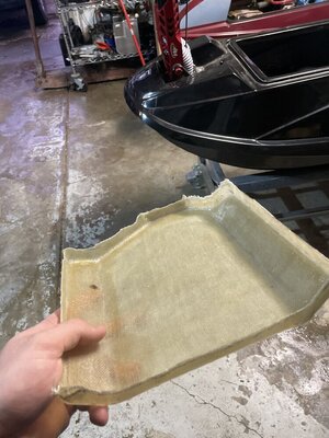

Fabed up a custom tank pod. Going to glue it to the hull for my rad dudes tank. Used vegetable oil as mold release and masked off the rest. Going to add a few more layers since it has a little more flex than I’d like. Sand the edges and hit it with some black paint then she’s good to go.
