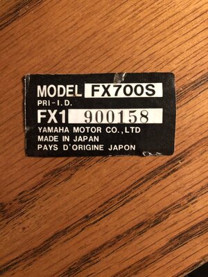

l got this lD label with the ski.l think it goes right under the vin.Can anyone help?
