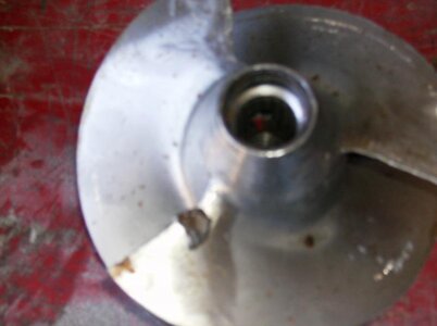

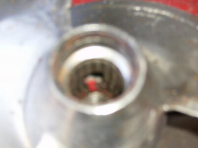

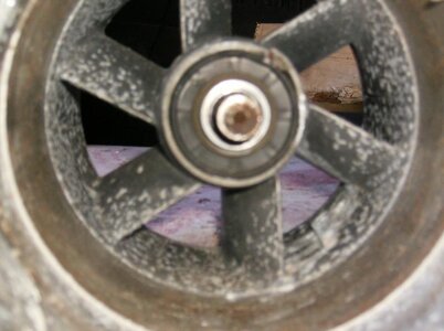

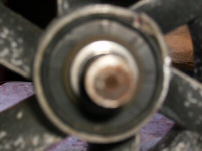

took prop apart today and found the culprit.
in the first pic you can see the little piece that broke off the prop.
and it wiped out the pump houseing
