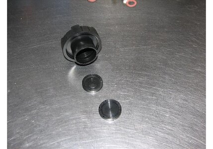

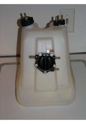

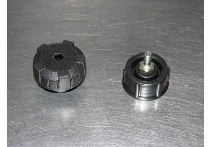

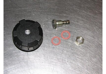

One more small but note worthy mod to the kart tank. Ordered a cap with a barb fitting so I can mount the check valve. Bought it off the same site I found the tank. Unfortunatly I don't think they make the barbed cap for the 9 litre tank

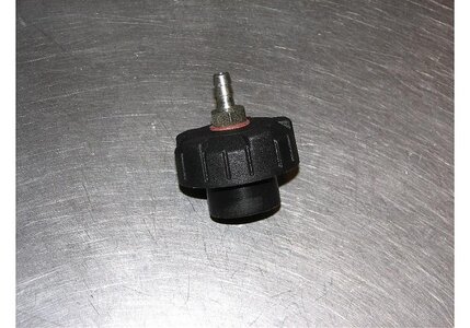

I did not know this until the new cap arrived b/c all I only saw 1 different cap available, no option for tank size. Had to improvise a little and modify the vented cap that came on the 9 litre tank.
**Remove the two septums pressed into the bottom of the 9 litre cap, drill the vented pin hole out to a diameter that will accept the barb fitting, add the gaskets (maybe a little sealent as well) and reinstall. I could not find this kind of cap from Acceleration Kart Racing but this works just as well. Perhaps other places have the cap, I just liked this particular tank so I went with
