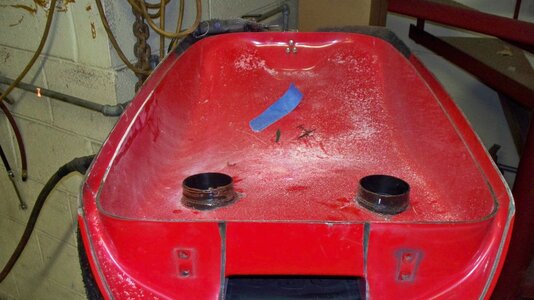

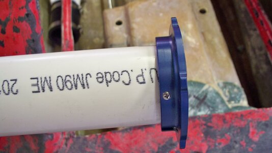

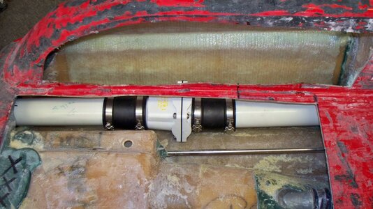

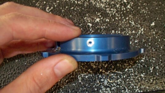

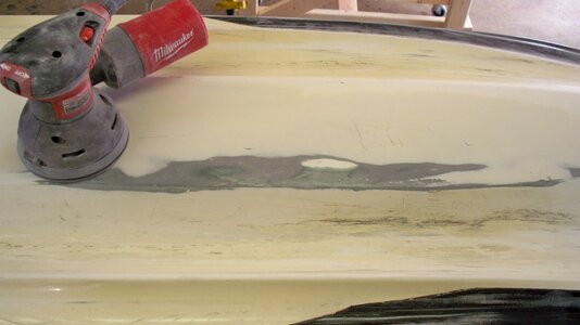

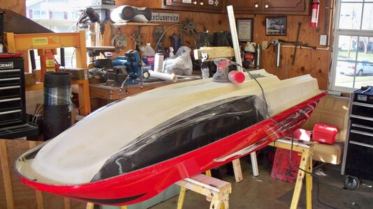

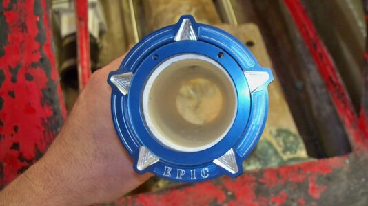

Hull Reinforcement and scupper. Flipped it over and started fixing the stress cracks on the bottom. The ski looks better in pics than up close as far as deep grooves,scratches and spider cracks in the gel coat ,
-I drilled a small hole and counter sunk a stainless screw in the the EPIC scupper along with the 5200 to set it and prevent it from possibly popping off. I also cut the pvc pipe to match the hull profile at the back and slightly heated the pvc to get the bend and best seal on the back of the EPIC plate.

-Bottom work
-Removed the decals that were cracked and peeling around all the edges

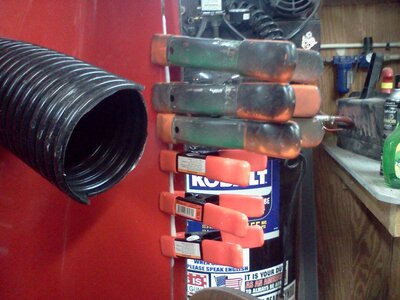

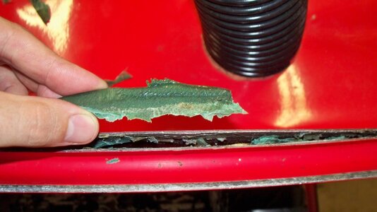

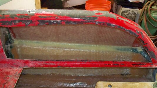

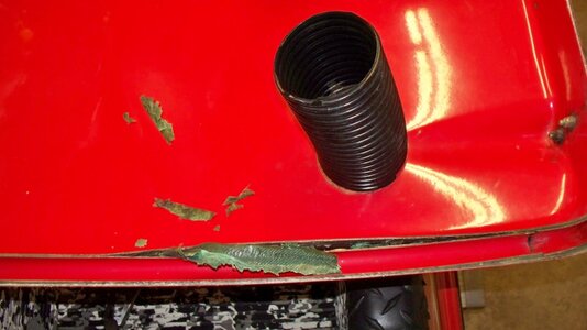

The Hood Liner was coming apart as the green epoxy failed. I removed what i could from the problem area and scuffed the liner and mixed some cabosil to re-attach it

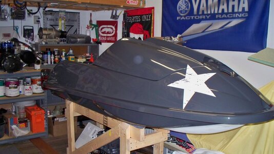

My PC crashed recently, pulling these photos from my phone, Hull has been painted 2 coats of Nimbus Grey from the Audi TT roadster and 2 coats of clear with a tattered star graphic laid in..I had a theme in mind for this build and didn't want to go back to the standard red like these were produced, my buddy was moving out to Cali and owed me a favor, so he painted it up. The ski is coming back to life!

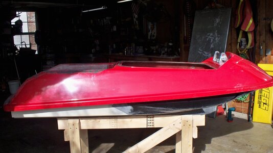

I also fabbed up a ski stand for the garage and him to paint on, all in all it was about 30 bucks from lowes, the wheels were the most expensive and they are terrible, I changed them out already

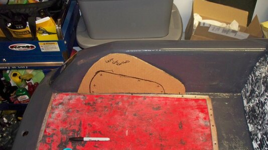

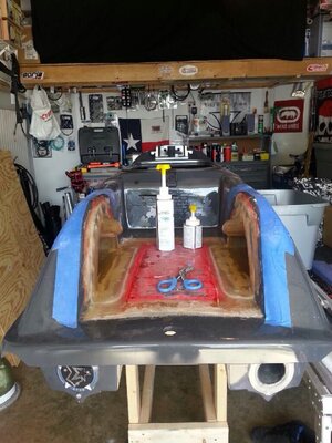

Packed in EPS foam under the tray, glass tray top back on, cut and installed Toby's 615 XL footholds, 5200's, rivet adn glass taped.. Nice part and price for my size 11 foot. Turf materials 8mm plush for bottom of foothold and 25mm plush for top-toe side and bottom of tray turf...
