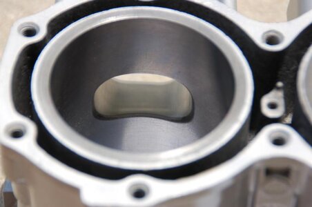

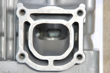

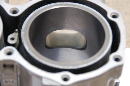

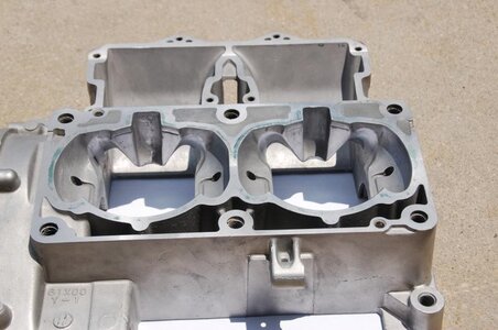

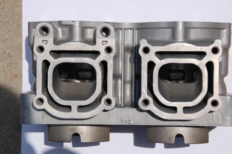

Ive finished all my porting and am now going to start assembling today, here are some pictures of the finished porting on the cases and cylinder.
teton
tetongravity.com
Washington DC

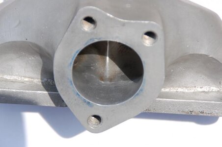

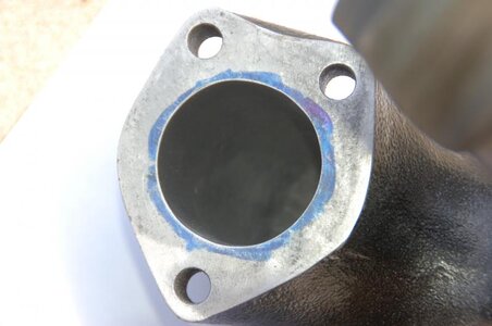

I also bored my factory pipe manifold to head pipe to 49mm they are also port matched to the cylinder.
teton
tetongravity.com
Washington DC
Why did you notch the exhaust side of the engine
I bought the cylinder used and it came like that.....no idea why
