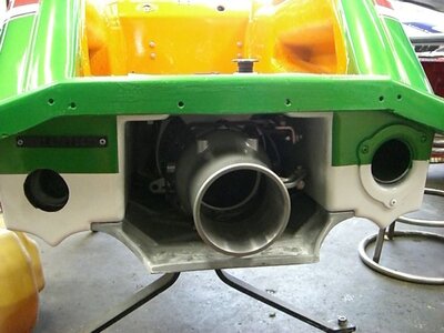

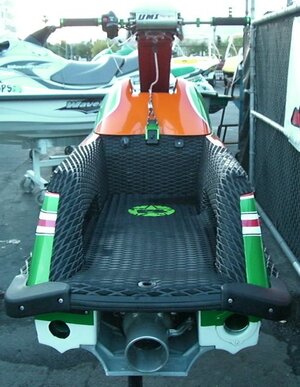

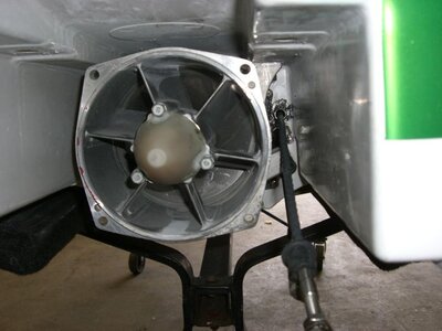

Here are a couple reference shots of the Blowsion nozzle that i put on a customers ski. You can see how the cable is run. Hope they help out....
