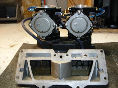

I noticed your extra post and I wanted to install a second pump and use both pulse lines ( previous ski had only 1 pulse line hooked )
So far not a big deal, hence I had some extra SBN 44's lying arround so I removed the blocking plate and installed the second pump on the second carburator, but then i ran into another problem...

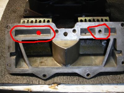

The Reed cage is only tapped for one pulse line, and technically it would not be a problem to just drill a second hole, but there is an opening that if not eliminated will cause some problems..
Any advise would be appreciated !
