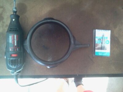

Tools needed
1. M6 x 1.0 Tap
2. 5mm Drill
3. Dremel Tool & Dremel Cutter I used Dremel high speed cutter #196
4. File to clean up the support rib on the steering nozzle

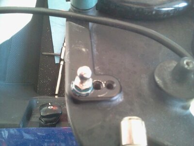

Step one pop of your chin pad and remove the steering cable and the ball joint. The ball joint on the turn plate and the steering nozzle are both M6 x 1.0 threads.
Step two drill the outside cast hole in the turn plate with the 5mm drill and tap. Apply blue thread lock and reassemble the turn plate ball joint and re-install the steering cable. Turn plate mod done.

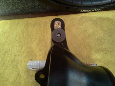

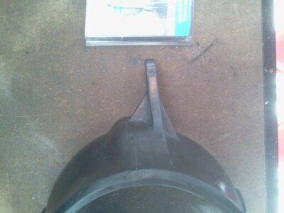

Step three remove the ride plate and steering cable. The steering cable nozzle ball joint has a 5mm hex slot in the ball end to remove it from the brass insert pressed into the steering nozzle. Remove the steering nozzle.
Step four use the dremel tool and the file to remove the excess material from the top and bottom rib of the steering arm from the steering nozzle to allow drilling and taping of the new ball joint mounting hole closer to the centerline of the steering nozzle.

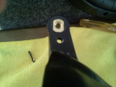

Step five use the washer from the steering nozzle ball joint to mark where the new hole for the ball joint will be drilled. Once marked use the 5mm drill and 6 x1.0 tap to drill & tap the new hole.
Step six re-install the steering nozzle use thread lock.
