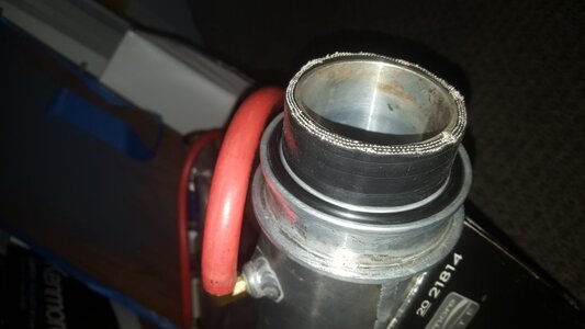

So I bought a powerfactor without the triple oring coupler. Took some of my exhaust hose, it slide over snug by hand, no heat, and fits perfect, without trimming the OD. No play. Better than the extra orings if you ask me! Talk about easy alignment! 20190702_131636.jpg20190702_131752.jpg
So I bought a powerfactor without the triple oring coupler. Took some of my exhaust hose, it slide over snug by hand, no heat, and fits perfect, without trimming the OD. No play. Better than the extra orings if you ask me! Talk about easy alignment! View attachment 379259View attachment 379260
Should hold up well and looks to be a good idea. You should post the I.D. and O.D. of the hose you used because it will prove to be helpful for some and someone is gonna ask.
Very slick
Are you going to run wet? If so I'm interested in how you route water lines and such, with all of the discussion on this nobody ever actually showed what they do.
the old one I have doesn't have enough slop to just slide on a thick hose and have it fit together.
you have to remove half the thickness of the hose, down to the reinforcement , to get it to slide in.
I use the rubber hose, not silicone
Yes, thats a "old" trick. Works like a charm :)

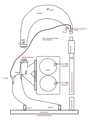

Hello Guys,
sorry if I re-open this thread, but I just made the change to get my Power Factor generation 3 exhaust (the last one) wet.
My setup IS:
Rickter XFS Competition 2014
ET 1107 with pump dome 185psi
MSD TL
Novi Carb 48 (G3) with Vforce 3 Big reeds
Pump Maxx Set Back 160
Impeller Skat Trak 8/16 Long Blade, Thin Blade
jetting: 100 for the injector and 120 for the cooling waterbox
In the next post including all picture of the mod thath I have made a the exhaust here fond the water routing that I have made.
Italy
This is my mod
Inviato dal mio iPhone utilizzando Tapatalk
