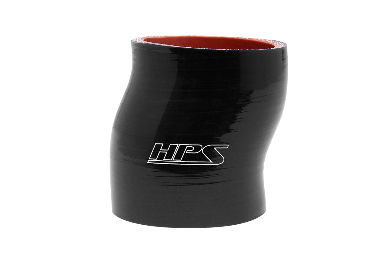

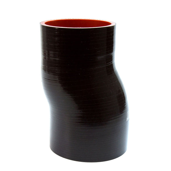

Your pipe figment looks normal, I had the same issue On a different hull.. I also bought an offset coupler for the pipe to water box in case I needed more room.. it’s like 1/2 inch offset hose from online silicone hose supply fir turbos..
This style hose in the correct size

I figured I would give one of the offset 2" couplers a try before I resorted to cutting. Here is the link to the one I ordered. It came out to be like $40.
It's tight. But fits fine. I didn't have to trim either block.
It does have to be disassembled and reassembled in a very specific way. And there was absolutely no way it was going to work with the pfp box.
