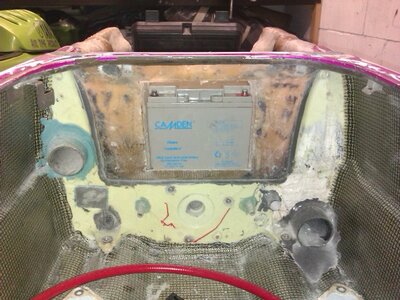

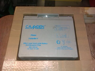

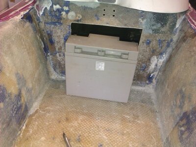

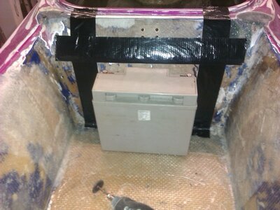

batt 1.jpgbatt 3.jpgbatt 2.jpgbatt 5.jpgfor insurance (3) (Medium).JPG we cut a hole in bulkhead behind elec box and glassed an enclosure in for battery. then turfed over it - the elec box holds the battery in place. the weight of the battery is then right in the middle of the ski. As we run total loss we made a charging point for easy plugging in of the charger.

I saw that looks like a good idea but witg my space limited i would have to pull the engine to remove the bat.
