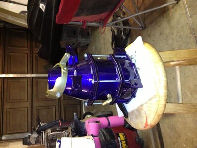

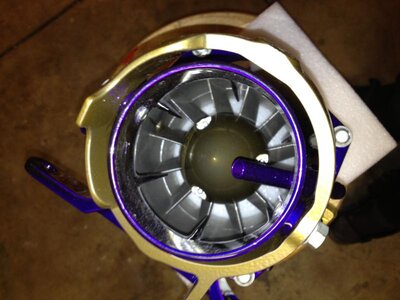

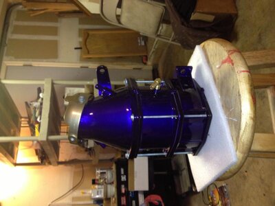

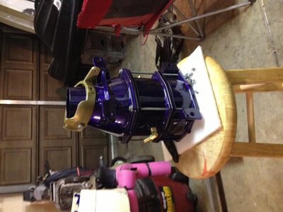

Just wanted to see what other people are doing to pump's to make them one off's here is my 144mm yamaha pump with 12 vane solas mag and waveraider trim nozzle all powder coated. IMG_0152.jpgIMG_0154.jpgIMG_0151.jpgIMG_0153.jpg

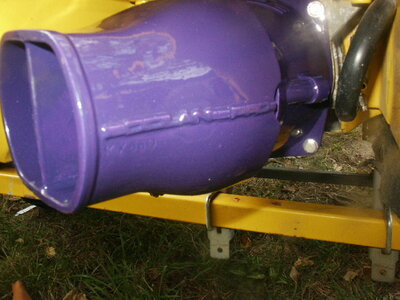

Didn't do the pump , too lazy to pull it out, nozzles sprayed with single stage Deltron deep purple

Thanks alot guys as far as powder coating holding up in the ocean i have a epoxy primer powder i would lay down first and it will give it some extra protection from the salt. But like anything other then plastic metal and paints will always eventually get broken down by the salt i would say with the primer down first and with a good wash after every ride you could get 5 years out of it. see powder when baked out all the way can be flexed in half with out breaking. for and example i will get some pic up of this its pretty tuff stuff and looks good
