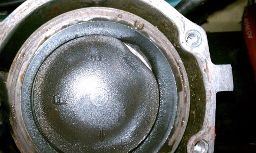

This is out of my rear cyl. 701 bored .75 and ported, 33 cc domes around 185 psi. The missing corner is near an intake port.
Anybody give me an indicator on why? I run around 93 octane or so... front piston looks perfect, good wash and color on the plug. Is this heat related or crack? the edge isn't sharp, it looks bead blasted.
Thanks for the feedback.
