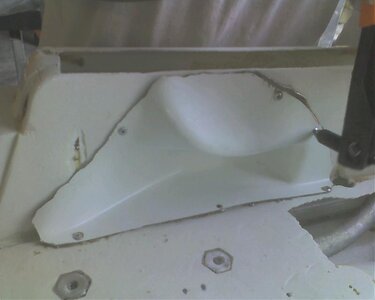

After that we Trimmed down the Kickers to Fit the 550 tray shape instead of the more rounded SN tray. Sanded laid our epoxy and riveted them in. They will look alot better when their glassed in.

Last before we wrapped it up for day 2, The 550sx hulls have the Retarded Divits in the side of the tray walls and I want to glass those flat for easier turf job while its already under the saw. So i sanded, laid my tape down and mixed a little more foam to fill those areas so I could sand and shape them how i wanted them before we glass.
