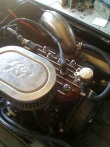

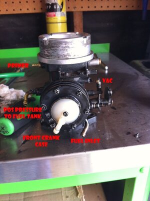

it turnes over and gets spark so i was thinking its a fuel issue, however, when i put fuel down the carb it doesnt start either. now, i was going to do a comp test but i just fried the starter trying to start it and have another one on the way. but i think the PO might have also hooked up the fuel lines wrong. heres a pic of how he had them.
i am totally new to this but have automotive experance. all i could think of is maybe timing is off?
also, i know the rev limiter thing looks to be disconnected as the power lines goin to this are caped.
oh, another issue is that the carb needs to be rebuild as i can see fuel leaking from the throttle shaft. should i rebuild or put a better one on? if better, which one?
i also see that the PO used RVT (red stuff) to seal everything, is this ok on a 2stroke? or should i find gaskets?

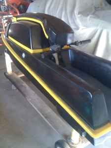

thanks for all the help and sorry for the questions, been searching all over this site for stuff and still struggling some. here is a few more pics of how i bought it. stupid kids spray painted it all LOL
