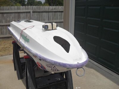

I am planing on sticking a layer of mesh inside each of the openings I ground through and a couple on the outside.
Is there anything equal to the spot putty or laquer putty used for autobody repair, or do you just have to get the resin nice and smooth?
I know I used auto (orange colored) spot putty to fill scratches last time and looks like that was a no-no.

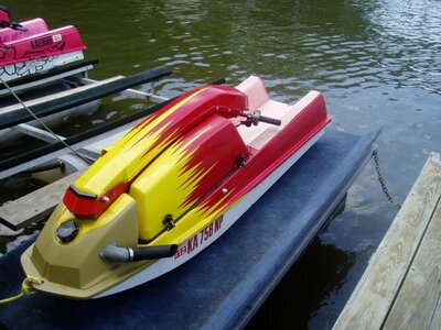

this is my 440 that i have had for 25 years. i put a fist size hole in the front right corner of it in 1994. it is still in primer, repaired it the same way in 94' it has had some big power in it and not even one crack!

Either way...I had already got the epoxy resin and used the mat out of my "Bondo" kit. I would have needed hardener for the resin from that kit too. But, I pulled the gas tank and water box out. Cut some strips and squares to patch up the backside. Patched the outside and started smoothing out outer areas. It was still colder than I preferred, but wanted to get on it. Hopefully this weekend I will sand the outside patches and apply another skin coat of resin, hoping I am on my way. I appreciate knowing that I may not have needed the epoxy resin, but I did hear a bunch of times from others on ski and offshore boating sites that "epoxy sticks to everything" or pretty similar to that. I did a far better job prepping and added the inside mesh, hopefully strong enough to hold up like yours. Screaming440-what a cool facebook site:) That Vintage stuff is AWESOME ! ! ! Growing up in Grand Rapids, not far from Butch's and being in my early 40 now, those were "the good ole' days" AWESOME STUFF ! ! ! Thanks everyone :)

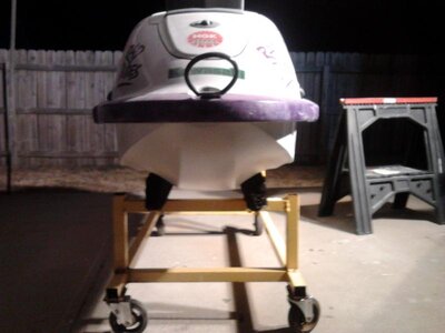

Not looking like I will need anything else for product at this point. I used the West Systems 105 resin. Glassed a few layers inside. A few more outside where I had ground out the small cracks. The only hard part was getting the resin to set where I needed it. Getting any kind of fill or build up was difficult. I have since been told to use Cabosil for a thickener and I think that would have made things way easier, next time I will know. I actually used some thick vinyl tape to make "dams" and hold the resin in place a couple times. Just spread what I think will be my last coat of resin last night. AND it is finally above freezing temps here:) Talk about timing. Everything looks solid, maybe even better than original in the repaired areas, thicker and more cloth matting for sure. I am hoping just sanding, paint, my homemade replacement decals, clear over those, and put the filler neck for the gas tank back in...COME ON SUMMER ! ! ! !

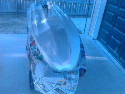

Well the repaired areas seem solid as can be. I have everything smoothed out sanded and been trying to paint now... I have 5 or 6 attempts at getting a nice coat of spray can enamel gloss white. On my 3rd brand of spray paint and I just cannot get it to lay down nice and smooth:( I thought it may have been the weather the first few times, but not sure now. First 2 or 3 times it was still cold here. Paint would go on nice take a wet sheen then start orange peeling, fish eye ing up, then getting a crackled look. I been wet sanding between tries until everything is nice and smooth again then reshooting. It's just spray enamel, right? Last night temps were in the high 60s low 70s, figured this would be it. Wet sanded lightly with 400 grit and started spraying. I have tried LOTS of light coats and waits between, but got some rough finishes. Thought I would get more adventurous and laid everything on pretty heavy. Close to runs and sags but not quite. First few coats looked good. Could tell it was getting thicker. 3-4 minutes between sprays. I started packing up for the night, figuring on last coat and head in for dinner. Get ready to spray and crackles, bumpy, and orange peely. Almost looks like something getting lifted and leached out in a couple small spots. Really I think it is just shrinking or something. Or, only thing I can stretch my imagination to believe is that still wet from sanding. I blew everything off REAL good, wiped down with paper towels, then 15-20 minutes later went over with a tack rag, and started spraying. It was warm and sunny. Ski started out in the drive in the sun and everything had me figuring dry enough...I just have never had to work so hard to spray can anything:( Then I gotta get my new homemade vinyl printed decals on, clear over those, and get 2 new batteries. Hopefully some REAL summer weather will be here then. Appreciate any tips, tricks, or advice for painting the nose if anyone has any. THANKS ! ! !
