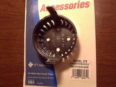

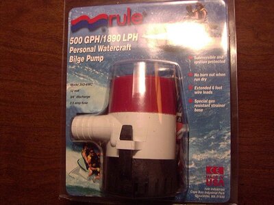

Don't know why Rule insists decade after decade to continue with that crappy (blue) strainer. However they have a black plastic strainer available which they tout as "gas resistant". It's a lot better plastic, I have never broken one! It's available as a separate part or as a pump assy. Sadly stores just stock the crappy, blue one.
