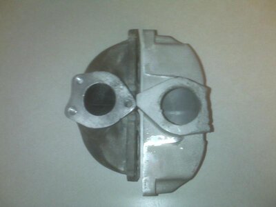

A jetworks valve is a must on all these pipes.
More info on the new manifold please, looking for that header opening to be in the 56mm range

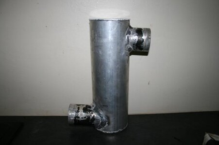

My new waterbox/ muffler, excuse the welding, it was my first time doing alu. Top cap will be get 4 cap-screws and sealer. It is 300mm high, inlet 60mm same as exhaust tube. Top pipe is inlet, luckily the exhaust tube in a X2 runs almost on the bottom of the hull so it will drain well.
