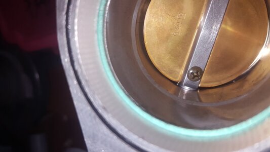

My assumption is that the 16 deg is the angle of the throttle plate when it's fully closed. If that is the case a different angle would have a different relationship between throttle position and the progression holes. I think that matters.

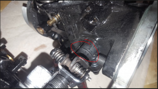

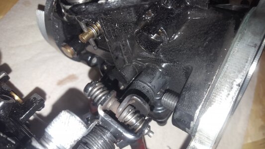

Also, the real reason I'm doing this is because of the oily discharge coming out of my shaft seals covering my whole mani and carbs. I'm assuming thats from bad shaft seals unless it has something to do with my damaged reeds shooting fuel back up my carbs.. 20181108_163817.jpg

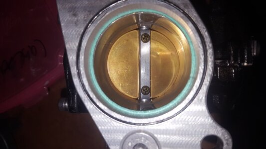

Here's a couple pics. They're not too bad.
@JetManiac can you verify anything about the 160 throttle plates?
And is that excess gunk just from bad throttle seals or an underlying issue?
This is more of any issue with a/m dual carbs often not aligned well, etc. OEM dual carbs have different linkage and setup which seem to last longer.
Roseand has oem dual 44s from a 760 so they are probably at newest about 20 years old, so they lasted pretty well.
I agree. Both of my sets had aftermarket linkages (it was a set of 46's and an old set of Novi 48's).
But even the oem carbs, especially at 20 years old, can have a little free play. You can see it in his picture, and I have a set of oem 44's that were about the same. I'm just saying I'd be paying close attention to this when rebuilding the carbs. Very likely it will come out nearly perfect with fresh oem parts.
