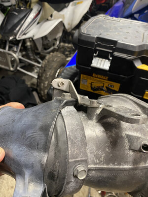

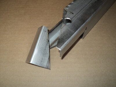

How about an 08+ oem superjet nozzle ? You can elongate the hole and get several degrees of adjustment out of it. I have one on my Superfreak on a 148 pump and it works perfect.
I may give this a shot, I was trying to simplify my setup and retain my spare parts. I like to bring a nozzle with me to the beach in case I bust one up.Nube this would be an option for you. The 08-up SJ and also 96-97 61x raider have 62t reduction nozzle with a fixed trim ring and steering nozzle. You can mod the bracket that locks the trim ring like long beach is saying to dial in a fixed up angle.
Just buy the SJ bracket, grind the little bosses down a touch, tap and it’s a fixed nozzle. The cheaper way is weld a rod. Super easy to do either If you have a few tools and 30minsBut it is a trim reduction nozzle, he wants a non trim setup.
Stock should be fine at that small of an angle, but a heim joint is easy to swap on.I may give this a shot, I was trying to simplify my setup and retain my spare parts. I like to bring a nozzle with me to the beach in case I bust one up.

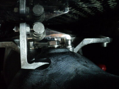

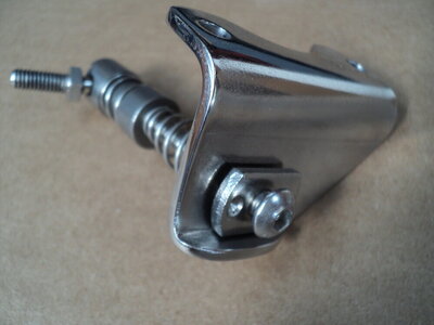

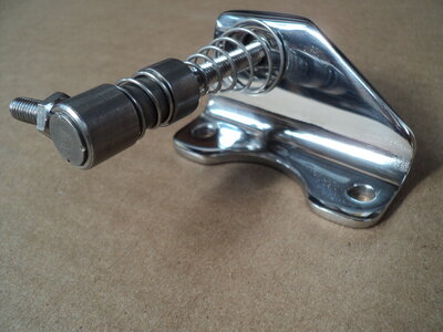

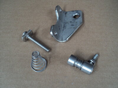

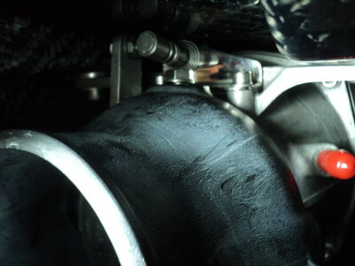

If I go this route, do I need to extend my steering cable or just switch to the ball joint style cable fitting?
Lets you really find the Goldilocks angle.thats pretty trick and you could adjust how much fixed trim you want. looks clean too
Remember, you saw it EXCLUSIVELY on the X !Awesome idea!
