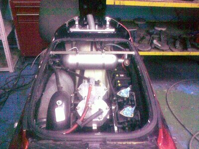

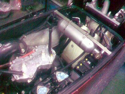

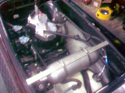

You don't have to get a mount like that made, there are plenty of cheap ways to mount this stuff, just might not look as neat and tidy or have that bling factor, it'll still work just fine. Looking at the OP's setup, he doesn't exactly fall in the category of doing a nitrous setup to save money, he's doing it cause he can and just wants to.
nebraska
Wilke,
I tried this system last year with a cheap mount on top of the engine and caused a lot of damage. A friend of mine designed this for me, in the long run I think it will save me some money. Time will tell...
nebraska
I installed 40hp nozzles this weekend, and went through over 10 lbs of nitrous. This thing runs awesome. Wish I had the balls to try some tricks ie: barrel roll, back flip. I will try to get some video.
