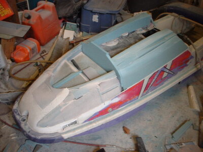

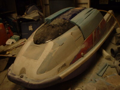

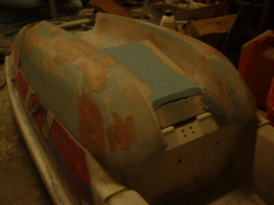

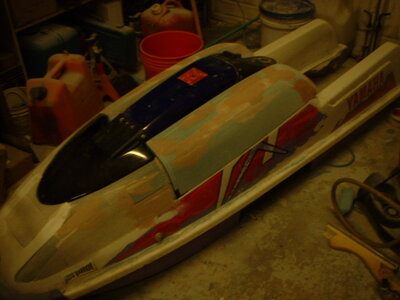

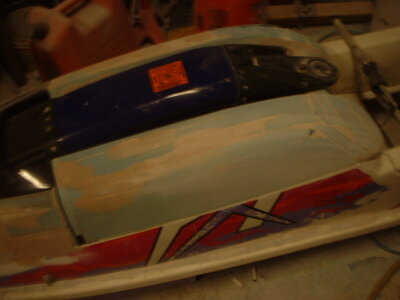

Did some work on the hood yesterday. Still need to add the valley the pole sits in. Lots of work & little progress. I wanna try this befor the water gets too cold:approve:

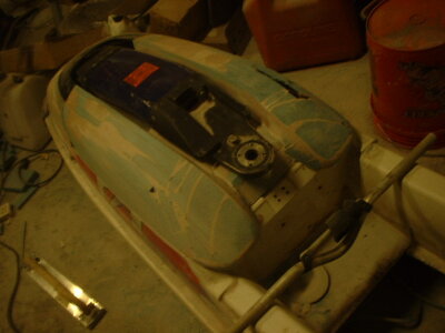

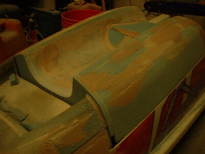

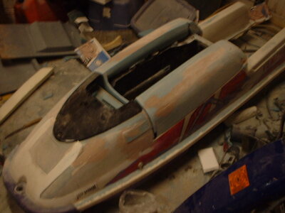

more work on the hood, still more to go. Stock pole cut 10 in. It might need to be trimmed more.

What an incredible amount of work. Good job. Is it me or are the bars going to hit the back of the hood? What's your process for making a new hood? Is what you have the plug for a mold or are you going to glass over it and then under it after the foam is removed?
The bars should clear the hood if they don't I'll make it. I'm planning on glassing over the foam then removing the foam from the inside then more glassing.

I understand the back end... but don't understand what you are doing to the front...
taking away from the bottom hull only?
I'm thinking it's going help my boat work shorter. I removed some of the flat by the pump & where the middle bulges in the nose will be gone & match the rocker of the rails. I'm thinking more rocker & less flat will make the boat respond quicker in front to back weight transfers.
