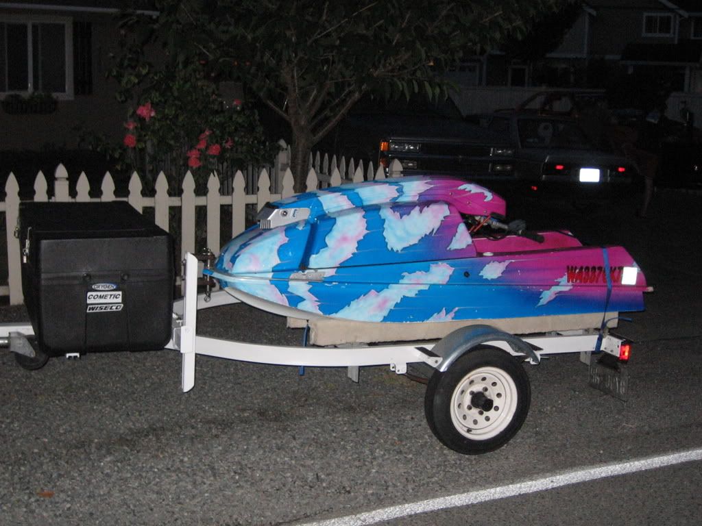

This is what it looked like when i got it. It was custom airbrushed in 1990, and wasnt cutting it anymore.

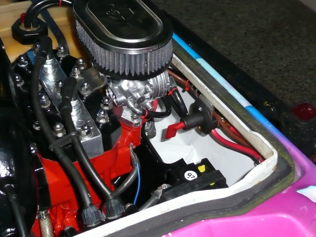

I cleaned up the engine bay first thing, and added a battery cutoff switch

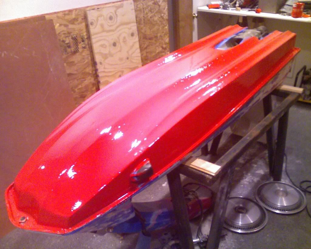

Then painted the hull

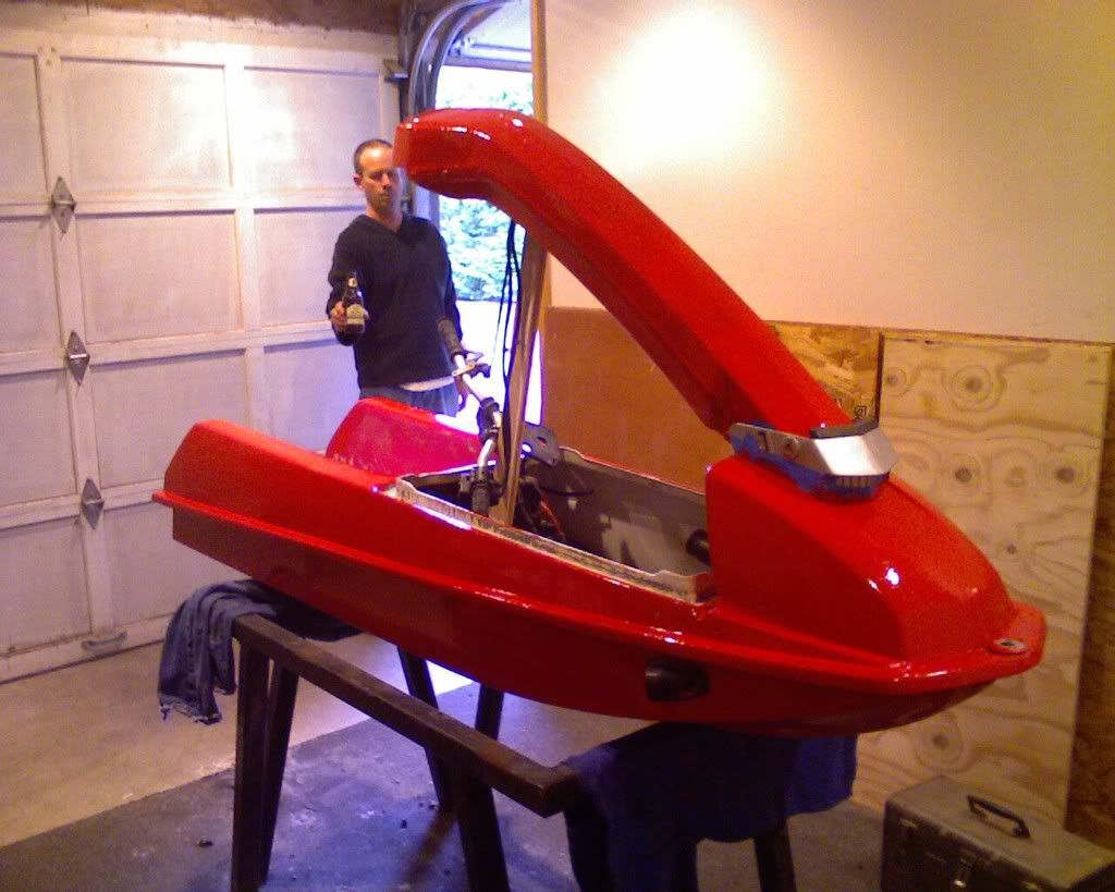

And finally the top side

i personally love that retro airbrush,, but most dont.

bump for a ski you could eat off of. awesome color choice. how easy is that interlux to work with? need to paint a few of my skis and have heard great things about this paint. curious as to what you did to prep the hull, and how the paint comes out when using a roller? clear coat as well ?

I didnt thin the paint at all, it was straight out of the can. As for prepping the hull, I sanded the entire thing with a belt sander. More so in places where the paint was in worse shape.
I used a foam roller, and tiny bubbles formed when i rolled it on. As the paint dried they all went away. I did two coats. No clear coat. Warning- The paint is a bitch to clean up compared to latex paint.
