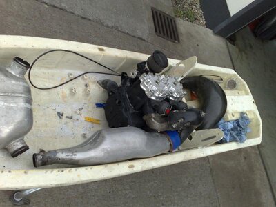

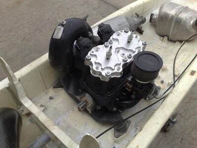

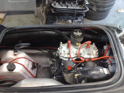

Looks like a stock Kawasaki bottom case with a Seadoo 951 cylinder modified to it with a spacer adapter for a Factory Pipe Yamaha exhaust manifold.
Thats right......Kawicases with 76mmkawicrank and lenghted middlepin.
In 2-3weeks im ready with the engine.....i hope engine runs:confused::confused::confused:
Some new pics from the engine.........

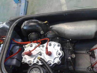

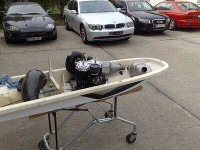

interesting motor setup,let us all know how it runs. funny how most these freestyle hulls are sxr based now.thats a real winner around here,lol.
Big Kahuna
Administrator
Tuscaloosa, AL
larger footprint for the power being used now. 3 years ago you were barely seeing motors that were 850cc. Since the EME 1000, XScream 1000 and the WDK motors have hit, plus some of the other Sled motor variations. The smaller motors did fine on the SJ based hulls. But now with the larger motors builders are starting to play around with the wider footprints. Look at the first years malone was on the polaris, he struggled to get that hull to break loose, as they started finding ways to get much more power he started being able to ride it like his SJ's.

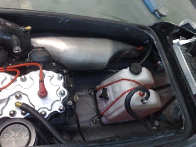

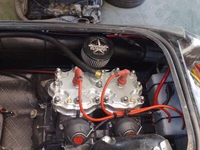

New pics.......Testdrive next weekend
