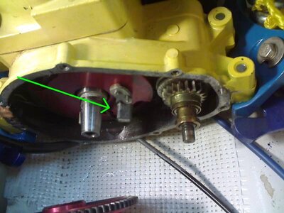

Well I figured out the problem... All the spacers I had to use to get the air gap right basically stripped the holes in the pickup. So I've bonded the pickup to the backing plate with 5200 and added the spacers between the backing plate and stator plate. Hopefully it didn't ruin the pickup.
