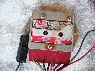

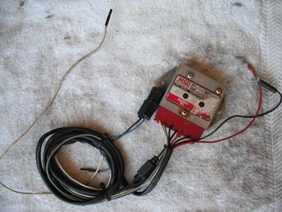

What is this MSD part? Are there other parts required to make it work? I don't need it and want to sell it but I don't know anything about it.

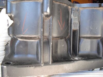

Can this cylinder be saved or is it now a paper weight? The outer wall is cracked but it doesn't look like it went all the way through.

That, together with a solenoid is used to inject water into the exhaust stream at certain rpm. I would think you can find that on the MSD site. The cylinder is junk.
