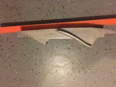

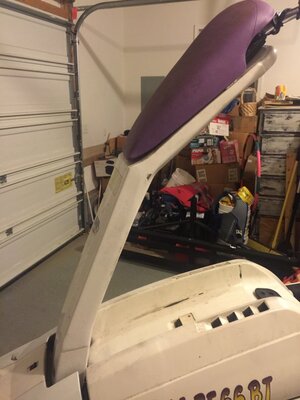

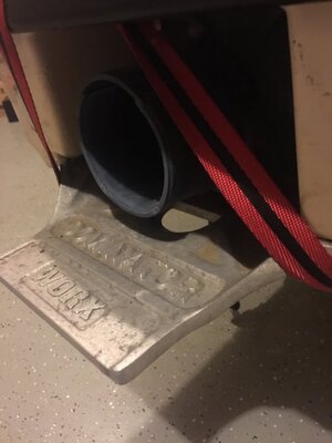

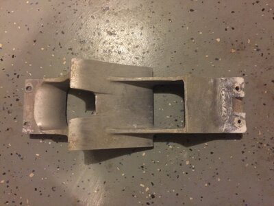

I am 6'3", 220 lb. Prior owner was close to same size and put on a lighter pole (fiberglass, unknown of length vs stock), an R&D scoop intake, and a Worx Dominator plate, which he shimmed to reduce the bouncing, though he admitted it never fully went away and he was very experienced. Is the cutout in the plate the "D cut" I keep reading about? Am I right in thinking this is a scoop intake? Don't think this is hurting me any, but throwing it out there as a possibility.
Was reading several others with similar issues and thought maybe a good finned plate would help with both the bounce and the loose turns. Also something a little shorter might help me sub and do other stuff easier, but not too short that the high speed turns will be a problem. Could it be possible the plate is so long, and being shimmed, that it's pushing the nose down too much and causing a bounce? What are some good ride plates that would fit the bill? Also, he put some sort of sealant between the plate and body. Don't think this is common from what I've read elsewhere. Why would one do this if there's no leak concern?
