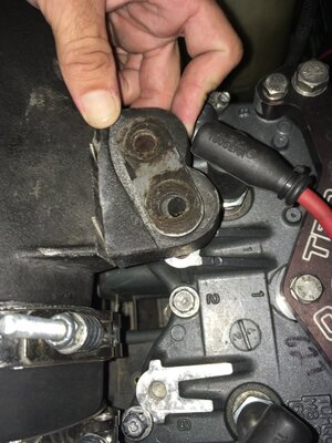

As you can see from my pic, even if I weld the top tab back on it does not line up with the head to mount it. I realized while the holes in the bracket for the exhaust manifold were only 5/16", the inserts for the pipe were 3/8" so I drilled the exhaust bracket holes bigger and went to 3/8". Made it threw the entire day, so maybe this will work out again.

Well, after drilling out the bracket attached to the manifold for 3/8" grade 8 bolts, and getting a 2.5" long one for the top hole so no threaded area is where the brackets meet to shear, I've stopped breaking bolts. Made it threw at least 10 tanks of gas now, was only getting a half tank at most in the beginning of the season. Woohoo!
