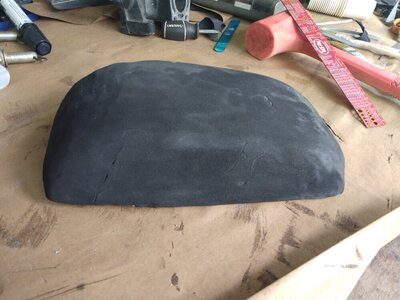

So the turf is now done and boy did it come out looking sweet !
Just kidding , what that actually is a protective pad I made for working on my skis, you can lay your tools on it and not have to worry about staining your turf, also useful if you have to climb under the ski to remove something from the pump, the straps are there so you can run a bungee under the ski to hold it in place.
