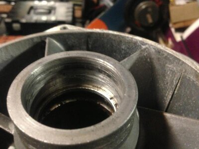

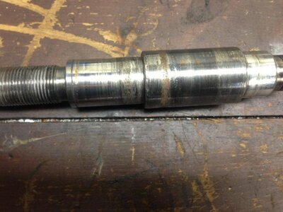

Hey guys my pump went last season and I took it apart to find the bearings in pieces. Now my question is am I able to still use my driveshaft and stator, I will put up pics. The stator section looks good to me but I'm not an expert.

I would try to polished the matting surfaces and then see if its still in tolerance after its cleaned up. Go from there.

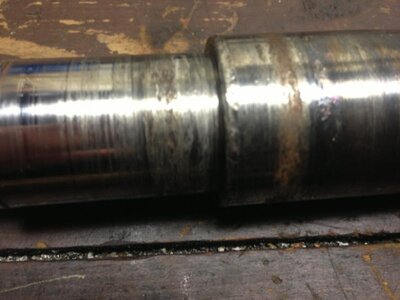

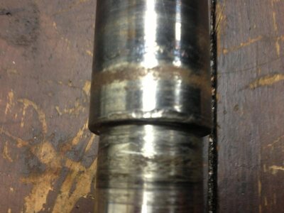

From that last pic it looks like the bearings rusted and became dry and when you used it the race around the bearing can't take the heat and it let's loose then the loose ball bearings destroy themselves. You could clean and polish the shaft but the new bearig life will for sure be shortened. I personally would check into the guys offer two above this post. You might chase this problem forever until you change the shaft and bearings.

Take some better quality pics, but how are the splines also? Shaft is probably ok.
Here are some better pics

The splines were a little messed up from when I changed my impeller because i used a vice and that's when my pump started making a weird noise but I just through it in there I was kinda rushing to get out.
But I filled them back to how they were
