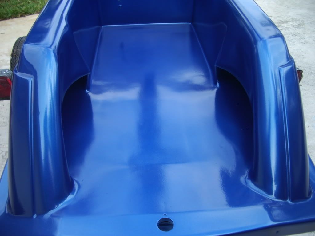

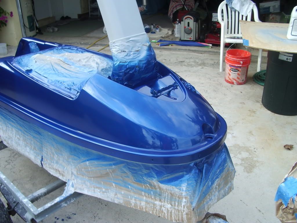

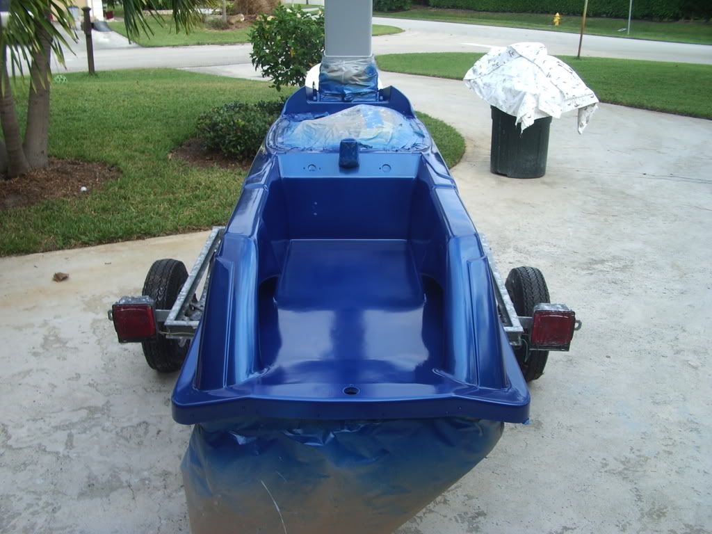

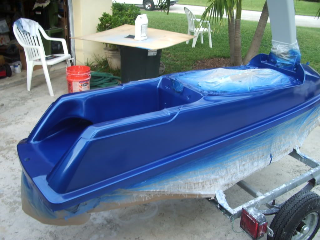

i started to paint my ski today but didnt get to finish. i stil need to wetsand the clearcoat but what do u guys think of the color ?
Clean, New, Looks Great, Nice clean work
Good Job
Like the color! What type of paint did you use? I'm getting ready to paint my js & went with an acrylic enamel...almost the same color too
NICE looking good. why did you do the tray? and why dident you clear after the base tacked up? looks great though.. all outside?!
looks great!!!!!!!!
now some advice, sand off the areas where the turf is going to meet the hull, this way the turf is glued to the hull and not the paint........... If you are going to turf the side rails, sand all the paint off, otherwise the water will rip the turf off along with the paint.........
