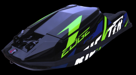

Just a question. The "bond rail" on the 2021 Rickter Edge goes a little farther forward and around the nose a little more than your design.
Why is that?
I wonder if your shorter, straighter, not around-the-nose bond rail will not hook up as well, possibly skipping out when you try to engage the nose in a nose-carved turn?
Your work is great, so please understand that I am very interested in hull design and this is just a question. Please keep posting and definitely post a ride report.

Well thank you for the compliments, but this is actually not MY design - I am just fixing some of the aged/damaged glass-work. I believe this ski was originally modified circa 2010-2012! The nose of this ski incorporates a rocker-kit from a (former?) forum member CarterB. He offers a lot of hull modification kits for Blasters/SJ's and other hulls...
I have been warned that I'm in for some non-stop splashing to the face due to the design, so I may incorporate some-sort of (possibly 3D-printed) lip at the front, but as far as the ski's ability to carve - well, that will more likely be limited by my zero hours of tray-time as I'm a complete rookie to riding and will take some time before I'm pushing the ski anywhere near its capabilities... like honestly if it handles poorly in a turn I wouldn't know any better and would just assume I'm riding it wrong lol
I have recently seen some guys incorporate a bond-rail all the way around the nose (theres an awesome Krash re-build and some other rockered SJ builds in the My Ski section right now as examples) but I feel like If I keep trying to make this ski "perfect" before ever even riding it, i'll never actually get to riding it!!
Understood and agreed. Get it done and ride it!
BTW, just like beginning snow skiers, most newbee stand up jet skiers (like me) start up by being "heel pushers."
So, you will likely start your riding career by tipping and loading the rear inside rail of the ski (i.e., "pivoting" the tail).
It takes experience and courage to give up on the friction which burying the heel gives us and to "lean into the punch" both in snow skiing and jet skiing.
Both snow skis and jet skis initiate a carve very well off of the front inside edge of the ski.
By the end of the Summer you will likely be ready to make more performance hull modifications to your ski including maybe extending the bond rail. And you have the drive and the fiber glassing skills needed to do anything you want to do with that ski. Here is a photo of the bond rail curving around toward the tip of the ski that I am talking about:
