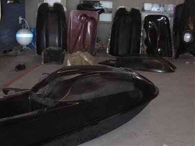

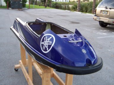

My amature class legal freestyle superjet build.

Looking good!! Can't wait to see it 100%. I relate to breaking the bank. I am just now recovering from my project and it is not done yet. You are using a mag pump right?

i sold like 5 toys this winter to build 1. its a stock pump, blueprinted with a TBM stuffer. actually the same pump that Ant used at WF on the white boat.(different impeller) its got a scat-trac magnum impeller. not sure what pitch? i honestly forget. ill check.
