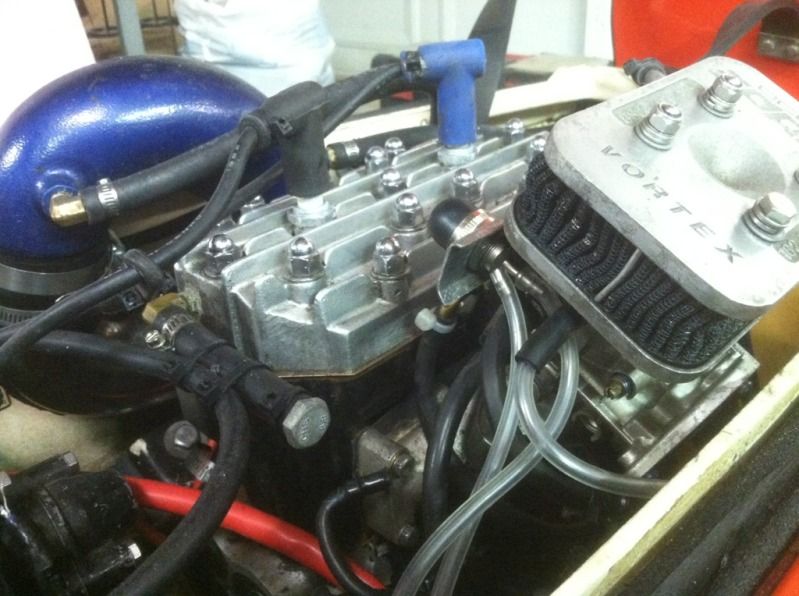

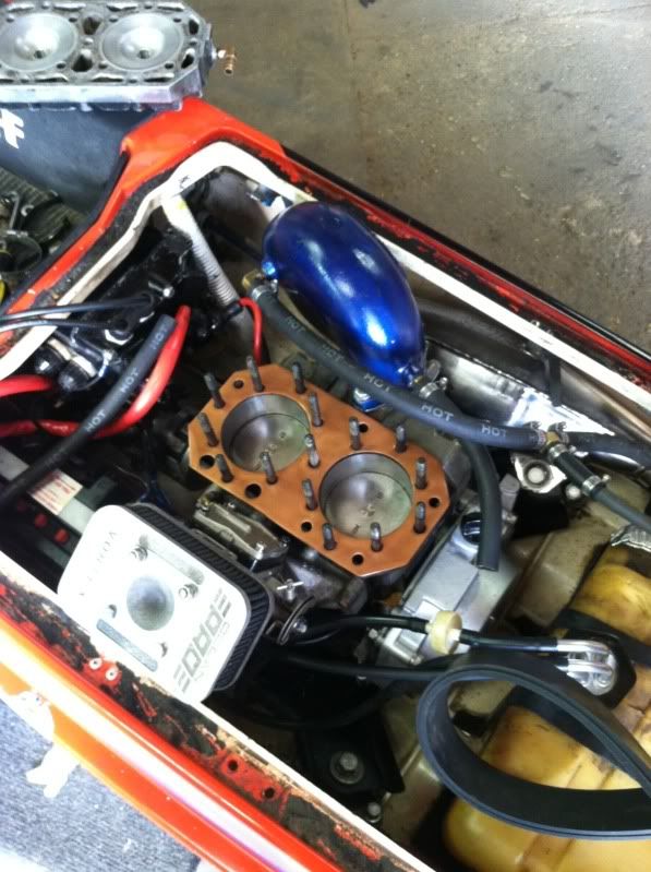

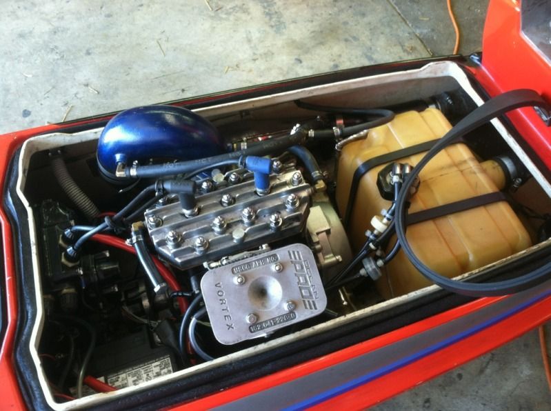

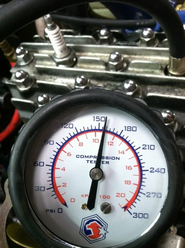

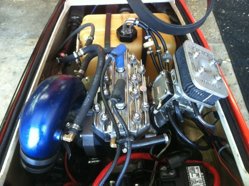

Nice ski! That pipe looks super short though. I think you would be better of with the stock Jetpower exhaust. Your compression is a little low with that high compression head. Did you just finish rebuilding it? It should be 175-180. If you just rebuilt it, your compression will go up after you run it and break it in.
MikeyB
H2O-Addict®
Michigan
Thanks! That compression number was right after I assembled it, to be honest I haven't checked it since then. It runs pretty good for a piston port 550 so I probably won't change anything, I'm hoping I'll get my hands on an FX1 by next season.

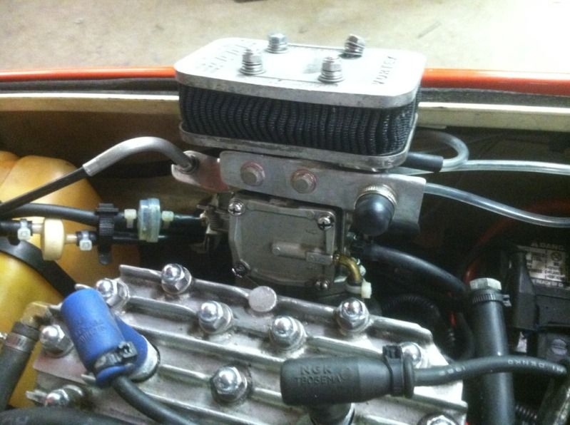

Ordered a few things today, flow control valve, new lines, msd plug caps w/retainers and then a different style air filter that I'm going to try to use with the 45degree intake manifold. I also decided to pull the trigger on a gopro hero2, thank you visa!
