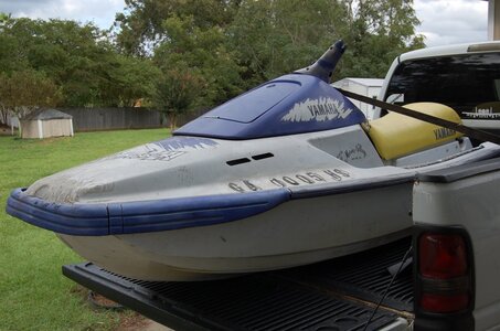

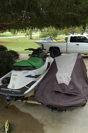

I knew from the dark picture that one was a Waverunner III. I knew the other was a ratty GP but I was thinking a 760. You could only have guessed how surprised I was when it was a 1200.
Well after I got home and put the kids to bed...it was to late to play so I went to bed. At 730 this morning I started in on the waverunner III because honestly...I needed that 650 motor for a perfect condition VXR I have that I robbed the 701 for my WB1. The 650 didn't have a carb but a compression and iginition test showed great spark and 150psi in each cylinder. My guess is someone pulled the carb back in 2002(last registered) and it got lost or??? Well pouring gas straight into the intake yielded a very excited motor and once I slapped on a trashy old 44 I had...she idled like a dream and revved out strong! I made quick work of pulling that motor and grabbing a few other bits I wanted.

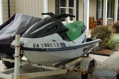

Then it was onto the GP1200. It didn't want to key start and the display was so trashed I couldn't tell what the licorice was goin on. So I pulled the box and jumped the solenoid to start getting some numbers. Great spark and good compression (135,130,135). She is still on oil injection which is a decent sign but will be tossed in the future. I left it alone for a while cause I was tired of jumping the solenoid and no way in hell would it fire anyway since it hasn't run in 5 years. Well this afternoon I had wrapped all the other projects up and went back to the GP.
I quickly diagnosed the fact that the display was sometimes allowing the key start to work intermittently. So I grabbed the switch from the waverunner III and it was cranking EVERY TIME. I poured some fresh premix in the airbox and hit the magic button. After every reattempt...she did better and better and then...LIFT OFF! She sounded just like my 97 1200...full of badass and ready to rip. I poured some fresh fuel in the tank cause I plan to run it on the hose soon but now comes the REAL dilemma....the Waveblaster has been BEGGING for a 1200 swap and this ole girl may just provide it!!!
