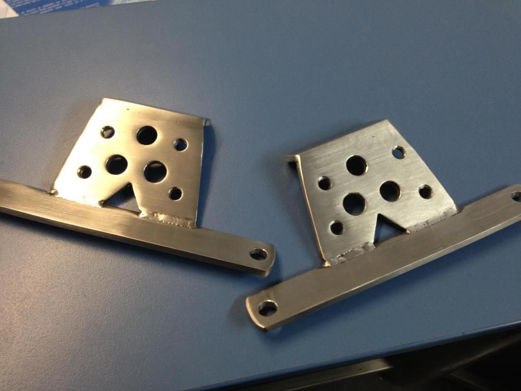

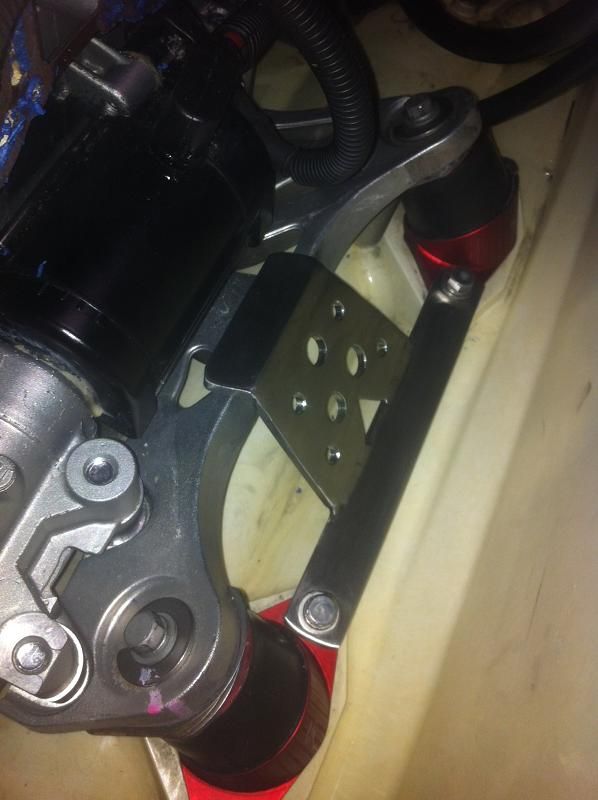

that looks interesting...
BUT... motor mounts are rubber to allow the motor to move and flex a bit..... once you load it up with so many supports and braces you lose that ability and you might as well just bolt the motor direct to the hull...
kraqus
Very ingenious set up!
They do not seem to be touching the engine plate thus allowing vibration to still be absorbed by the Rubber mounts. They seem to engage when the engine moves due to gravitational force like aerial tricks.

Even though these were made for blaster set ups, since fx1s and blasters run the same motor mounts, wouldn't these work on fx1s as well?? That would be awesome!
