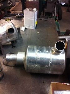

This my box I did it myself after long pm’s with scottymac. I’m not sure how you would get to this wall without cutting her open. I drilled one 1inch hole center bottom. Dasa920cc
I cut my waterbox open, drilled six or seven 1/2" holes and welded it back together. Sounds a bit throatier, maybe a bit of a bump in performance.
