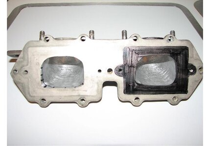

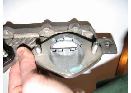

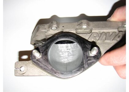

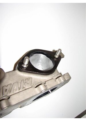

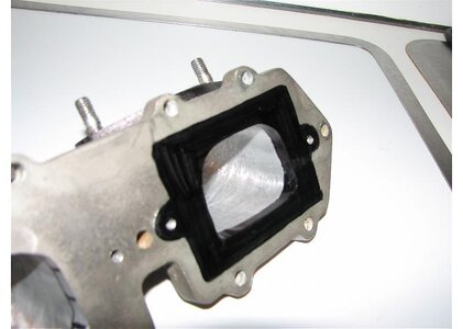

Here is what i was thinking of doing. The casting of the RIVA manifold is nice and thick allowing pleanty of room for this modification. It is also quite strong from what I can tell. Might be able to shave 7mm off the reed cage area, recessing it into the manifold and anouther 6-7mm off the carb mounting surface. This could take almost 14mm off the length of the intake runner and as you can see in the pic gives a nice shot from the throat to the reed cage assembly. I plan on running V-force 2's with this set up.
