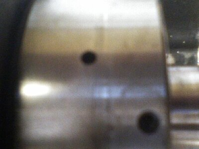

ok I know when I use three different engines to try and make one good one there would be some problems but I think I can make it work but I wanted to ask ya'lls opinion about this before I did it.
The Details: all my crank bearings line up on the guide pins in the upper case half except the fat one on the end by the stator/flywheel , I have tried playing with it thinking I must be doing something wrong but it just doesn't line up with the hole in the bearing . I know the picture is not so good but you can see the guide pin hole and right beside it there is a rubbed line where the guide pin lines up about 1.5MM in towards the flywheel:banghead:
Now for ya'lls opinion: I think that is just a guide hole to line the oil hole up. I was thinking of putting the bearing in the mill and cutting that guide "hole" into a oval slot so the guide pin would line up. IS THERE ANY REASON WHY THIS CAN"T BE DONE?
