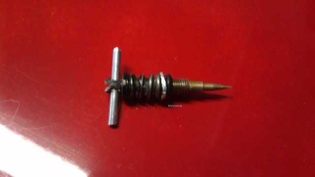

Custom/Hybrid Made my own T handle carb screws
I had an idea of making my own since Im broke and didnt feel like ordering any. I just found the smallest drill bit I had, drilled a hole, found a rivet tail that fit and cut the rivet head off:nana:. They work perfectly, especially in a pinch.
