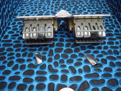

heres a picture of what happened last weekend.. it was running fine then poof.. real boggy.. (we were 20 miles from the ramp, (huntington pier from long beach) it almost made it back before the other one let loose.. no damage was done and both peddles were knocked back into and threw the reed cages.. this ski has skills !!
Nice!
