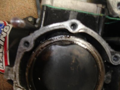

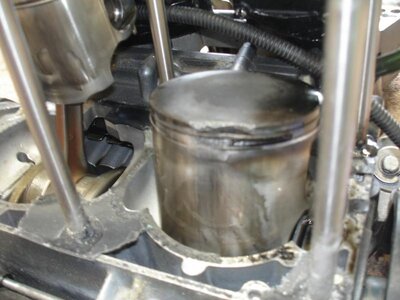

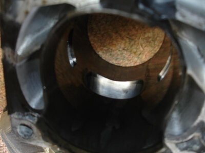

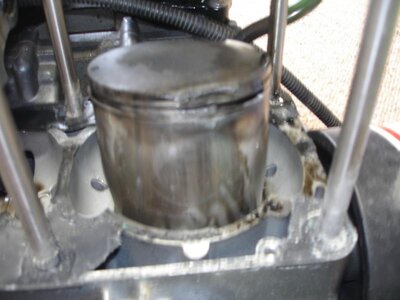

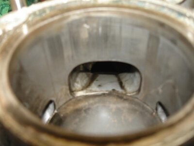

NO such luck on the 0-rings.
This might explain why this cylinder kept fouling plugs last year. That was the reason I switched it to total loss in the first place. I figured something was wrong either with my coil or cdi. I guess not.
Do you think the ring caught on the exhaust port? Porting issue? Something else?
The cylinder isn't even scored.
Just replace the rings and piston or do a whole top end?

The ring is still there but bent. There is a chunk missing from the piston between the rings and above the top ring where it is bent up. My dome still looks perfect too so I guess it all went straight out the exhaust port. I got lucky there.

IMO, look real good in the case for that missing piece, or pieces if it got eaten up.

If anything, the ring would've snagged on the bottom lip which I would certainly think is unusual. You'll need to check the tolerances on the cylinder itself and see if it needs to be bored up. If it does, that will certainly answer your question of whether you can replace both pistons and rings or just one. Either way, I would personally replace both just to call it good for years to come.
If the tolerances check good, I've got a hone and we can clean up those edges so it doesn't happen again.
That sucks man... I guess 2 years ago was my sucky year, last year was gregg's, and now it's your turn. lol I just hope the cycle doesn't repeat...
That is a lean melt down, not a snagged ring. A snagged ring does much, much more damage. The edge of that piston melted. Is this a dual carb ski? What is your jetting like?
