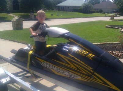

Check out my boy on it, he thinks it's his! Maybe one day.
